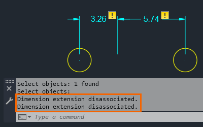

When a dimension becomes dissociated, AutoCAD informs with one of the following messages at the Command prompt:

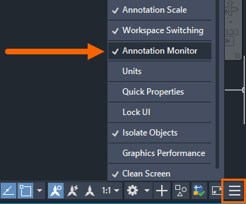

Click the Annotation Monitor status bar button to turn the annotation monitor on
 and off
When the annotation monitor is active, the Annotation Monitor icon is added to the status bar.
If you don't see the Annotation Monitor status bar button, click Customization
, located at the far-right end of the status bar, and select Annotation Monitor.

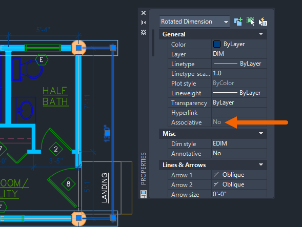

When the annotation monitor is off, there's no visual indicator that displays if a dimension is associative or non-associative. You can use the Properties palette or LIST command to verify the status of a dimension.

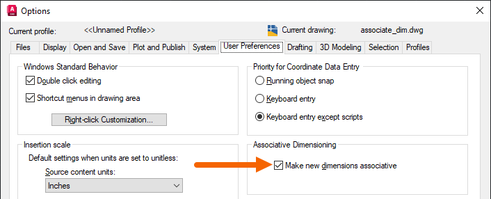

By default, all new dimensions are associative. This can be changed in the Options dialog box.

A yellow badge is displayed on the dimensions indicating they are no longer associated to the circles. Deleting the middle circle created two disassociated dimensions.

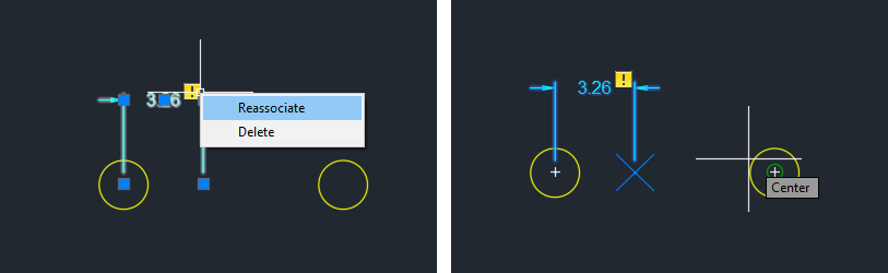

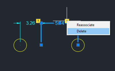

Due to a design change, we now have two disassociated dimensions. To fix this, we'll delete the dimension that's no longer needed and reassociate the other dimension to the remaining circles.

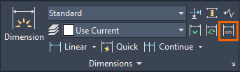

There are two ways to do this, one is from the ribbon and the other is clicking the yellow badge on the dimension. Both methods are similar. In the example below, let's click the yellow badge and use the menu.
Notice that the yellow badge is no longer displayed on the dimension. This indicates that the dimension is now associated with the centers of the two circles.
The dimension displays the new distance between the circles.
