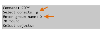

With the GROUP command, simply select the objects that you want to associate together (1, 2) and press Enter. Then, when you select any object in the group (3), all of the grouped objects are selected. A grip is displayed at the center of the group bounding box to provide access to all grip operations.
To disassociate the objects, use the UNGROUP command and select one of the objects in the group. The group association is dissolved.

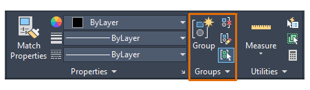

For easy access to the controls for groups on the ribbon, locate the Home tab, Groups panel.
The commands in the panel include Group and Ungroup, plus . . .
Group.  Find
			 The objects now belong to a group.
With group selection turned on, the copy of the group is also a separate group.
Group Selection On/Off  Find
Groups panel
Ungroup.  Find
