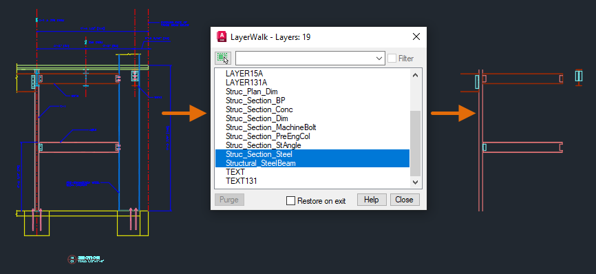

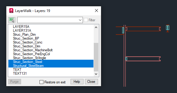

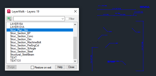

Working on an existing drawing for the first time, especially one from outside your company, can be challenging as companies often follow their own internal layer standards. The Layer Walk feature (LAYWALK command) allows you to see the objects on each layer in the current drawing. As you select layers, the objects on those layers are visible while objects on all other layers are temporarily hidden.
The following steps explain how to use Layer Walk:
Notice that only the geometry assigned to that layer is displayed.
Notice each time you press the Down Arrow key, AutoCAD changes the visibility of the selected layer to on and the other layers to off.
The objects on the Struc_Section_Steel and Structural_SteelBeam layers are now both visible. If you want to select a range of layers, hold down the Shift key and select the first and last layer in the range. All layers in between are selected and are now visible.
When Restore on Exit is cleared, the selected layers remain visible in the drawing when you close the dialog box. If Restore on Exit is selected, the layers in the drawing are restored to their state before Layer Walk was used.
Notice that only the Struc_Section_Steel and Structural_SteelBeam layers are visible in the drawing.

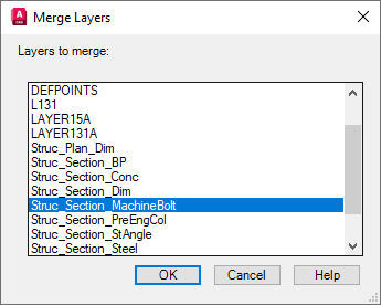

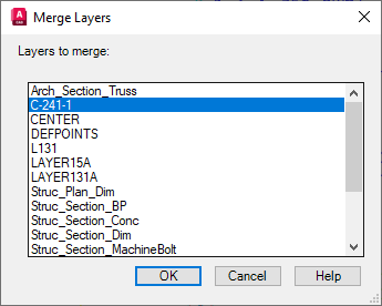

As you work on a drawing, there will be times when you need to update the layers in a drawing to a new set of standards or simplify the layer organization of a drawing by reducing the number of layers used. The Layer Merge feature (LAYMRG command) allows you to move all objects from one or more selected layers to a target layer. The unused layers are automatically purged.
The following steps explain how to merge layers in a drawing:

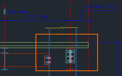

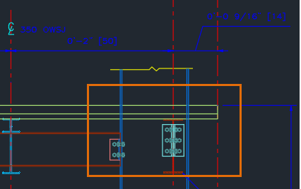

The fasteners are on two different layers, C-241-1 and Struc_Section_MachineBolt. We want to take the objects on layer C-241-1 and merge them with the Struc_Section_MachineBolt layer.
You could also select an object on the layer you want to merge as well.
The objects on the C-241-1 layer are merged with the Struc_Section_MachineBolt layer, and the C-241-1 layer is purged from the drawing.

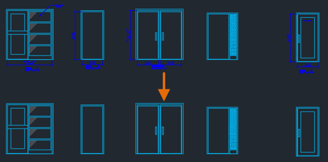

From time to time, you might want to delete all objects on specific layers. This can be beneficial to reduce the size of a drawing file or simplify the complexity of a model. Maybe you only need a general representation of a design when sharing it with others, such as a building outline to reference. The Layer Delete feature (LAYDEL command) allows you to erase all objects on a layer and then purge that layer from the drawing.
The following steps explain how to remove all objects on a layer and then purge that layer from a drawing:

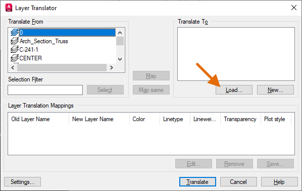

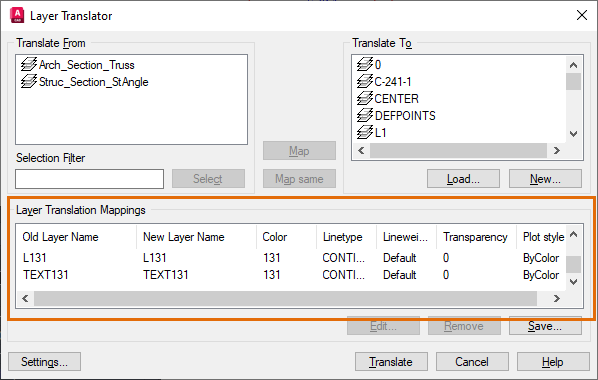

The Layer Translator (LAYTRANS command), available only in AutoCAD, allows you to create a layer mapping. A layer mapping is a relationship between layers in a drawing to those of a defined set of standards. You can use a layer mapping to:
The following steps explain how to create and use a layer translation map to cleanup layers in a drawing:
The Load button allows you to select the drawing that contains the layers you want to use in updating the layers in the current drawing, typically, this can be a Drawing Template (DWT) or Drawing Standards (DWS) file. You can also select a drawing file that contains a previously saved layer translation mapping.

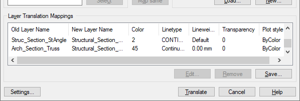

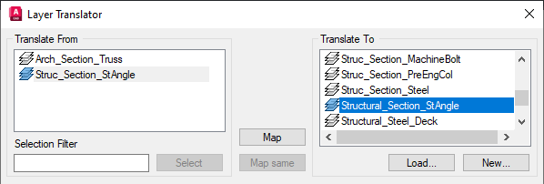

All layers with the same names between the two drawings are added to the Layer Translation Mappings section near the bottom of the dialog box. You should now be left with two layers that are not mapped.

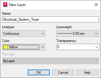

Not every layer we want to use was defined in the loaded drawing. We can add a new layer to map the Arch_Section_Truss layer.
All layers are now mapped.

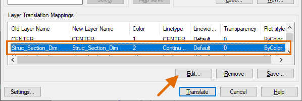

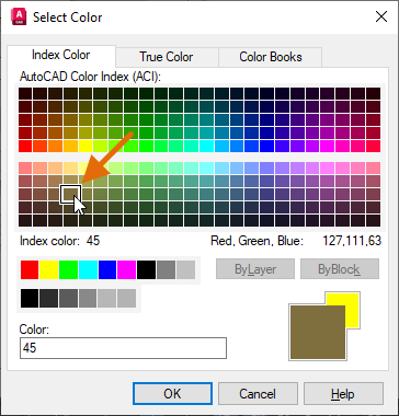

Based on the source of the imported layers, you might need to make some adjustments to the properties of the layers. You can edit the properties of a layer in the mapping by clicking the Edit button.
Here we will edit the properties of two mapping layers:

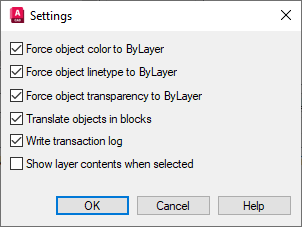

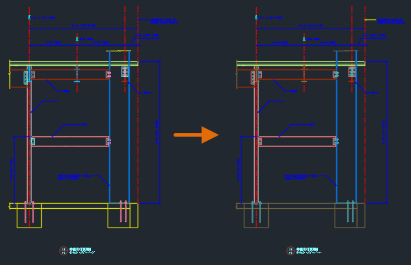

Now with all the layers mapped, you can optionally save the layer mappings and translate the layers in the drawing.
You can then edit and load the layers and the layer mapping saved to drawing file instead of loading Section2.dwg which we did earlier in this exercise.
