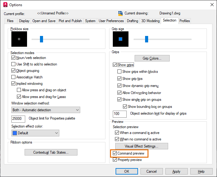

Before trying the examples, let's make sure command preview is on. This way you can preview the results when hovering over an object before you copy properties.

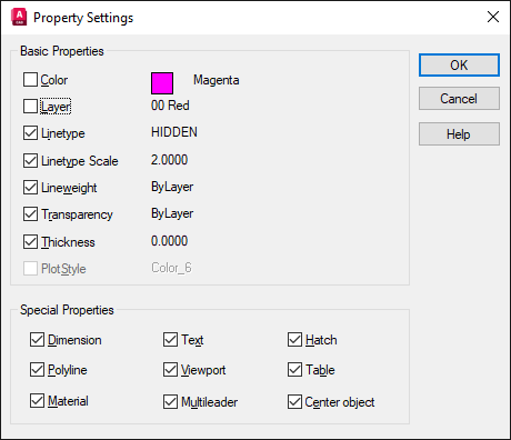

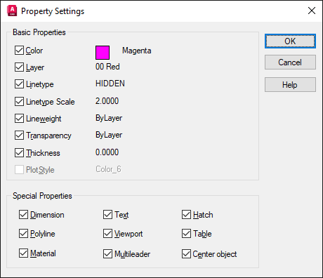

Remember the settings option mentioned earlier in this article? For this example, I'll copy properties from a line to a variety of other objects and use the settings option to limit the properties copied.
Some things to note about the property settings:
Notice that layer and color were not copied to the destination objects.

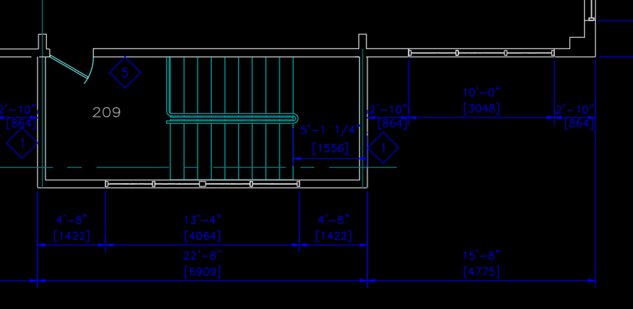

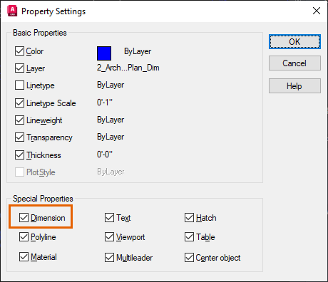

Sometimes you might want to copy properties from an object in one drawing to objects in another drawing. In this example, I'm going to copy properties from a dimension object to a dimension object in another drawing. For this example, we'll need to do some setup and look at the MATCHPROP Special Properties settings.
For more about templates, see Have You Tried: Working with Templates.
Now you are ready to see how MATCHPROP can be used across drawings.
Special properties apply properties that are specific to the source object type. For dimension objects that includes the dimension style and more.

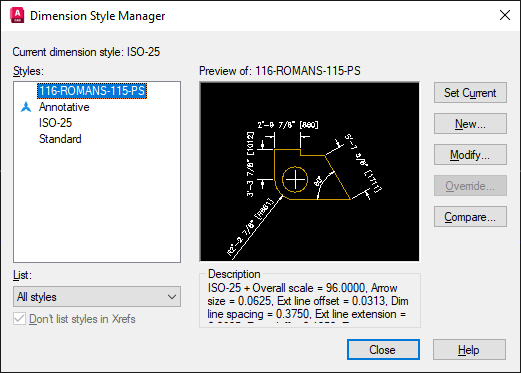

The dimension is updated as expected. But even better, if the dimension style doesn't exist it is created in the drawing! Double-check this by using the DIMSTYLE command. Find
When using MATCHPROP across drawings, any styles or definitions that are needed are created in the drawing. These can include:

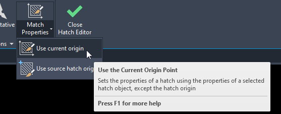

When you use MATCHPROP to copy properties from one hatch object to another, the hatch origin coordinates are also copied. To avoid copying the origin, use the following steps.
The Hatch Editor contextual ribbon displays.
This is considered the source object. The properties are copied to the hatch being edited.
