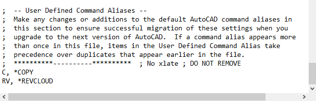

You can redefine or add command aliases by editing the acad.pgp file, or for AutoCAD LT, the acadlt.pgp file. In this example, you'll override an existing alias with your own and add a new one.
A little about the format of the PGP file:
<Alias>,*<Full command name
A, *ARC
This line in the file defines A as the command alias for the ARC command.
Always add your alias definitions to the User Defined Command Aliases section at the end of the file even if you are redefining an existing command alias. The last definition in the PGP file is the one the product loads.
It should look like the following once you finish.

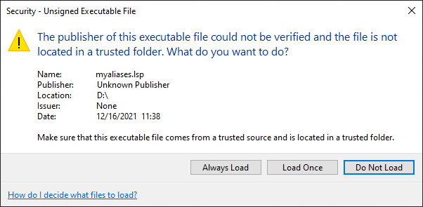

AutoLISP files must load before they can be used. You can load a file manually for the current AutoCAD session and you can set up your LSP files to automatically load every time AutoCAD starts.
You can also enter APPLOAD at the Command prompt.
You should see a message in the Command History window indicating the file loaded.

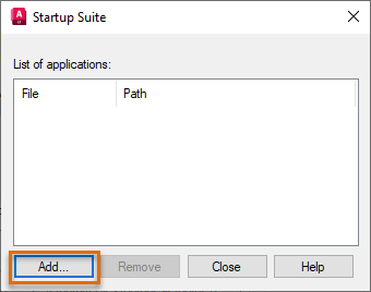

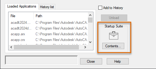

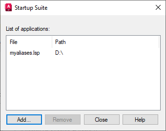

To load your LSP file automatically each time AutoCAD opens, follow these steps.
Next time you restart AutoCAD or open a drawing, the LSP file loads automatically and your commands defined in the LSP file are available to use.

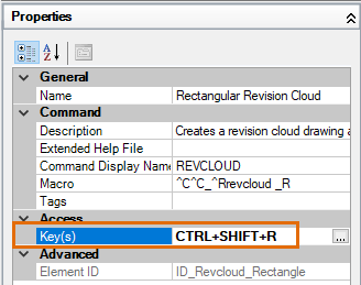

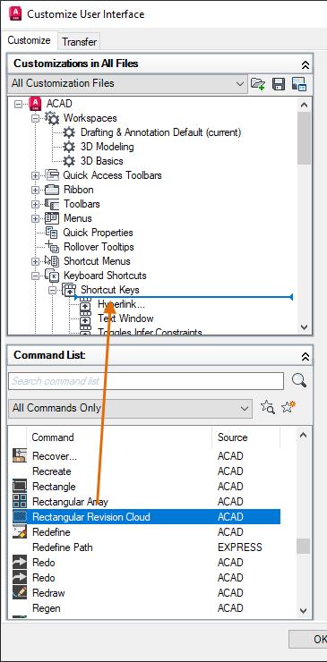

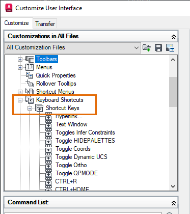

Shortcut keys are defined in a customization (CUIx) file. In this example, you'll define a shortcut key to run the REVCLOUD command with the Rectangular option.

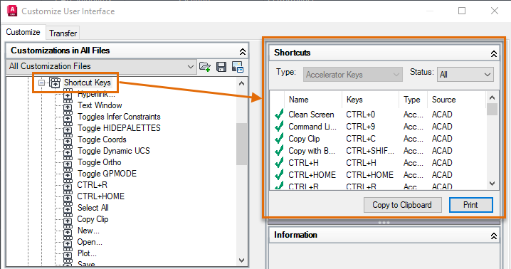

This displays a complete list of defined shortcut keys on the right side of the editor.
To define a new shortcut key, we'll drag a command from the Command List to the Shortcut Keys node and then assign a key combination to it.
The Properties section is prefilled except for the shortcut keys. We'll assign Ctrl+Shift+R.
The result should appear like the following image.
The REVCLOUD command runs with the rectangular option.

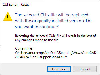

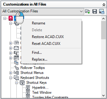

If you aren't happy with the changes you made, you can restore the CUIx file to either its previous saved state or to the program defaults.

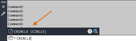

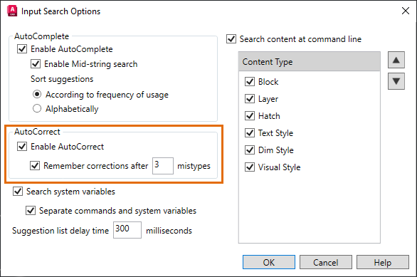

If you frequently misspell certain commands you might want to try AutoCorrect. With the AutoCorrect feature enabled, the command line suggestion list provides suggestions based on misspellings you have made in the past. You can also manually add commands and system variables to the AutoCorrect list that you commonly misspell.
This is so we can associate a misspelled word with a command in one try in this exercise.
You'll see Unknown Command in the command window.
This associates the misspelled WPIOUT to the actual command, WIPEOUT.
The misspelled command is now recognized as the WIPEOUT command.
Let's set the options back to the defaults.
You can also manually enter commands in the AutoCorrect file.
Notepad opens the AutoCorrectUserDB.pgp file. The format of this file is INCORRECT, *CORRECT.
You can see that it is now corrected and will start the CIRCLE command.
