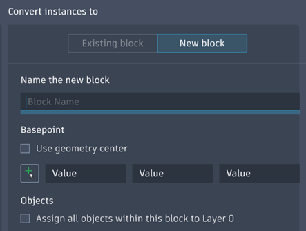

Smart Blocks: When converting instances to a new block, you can now assign objects within the block to Layer 0. This option is available in Search and Convert.
