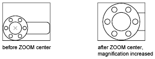

Center
Zooms to display a view defined by a center point and a magnification value or a height. A smaller value for the height increases the magnification. A larger value decreases the magnification. Not available in perspective projection.

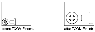

Extents
Zooms to display the maximum extents of all objects.
The extents of each object in the model are calculated and used to determine how the model should fill the window.

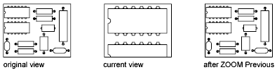

Previous
Zooms to display the previous view. You can restore up to 10 previous views.
