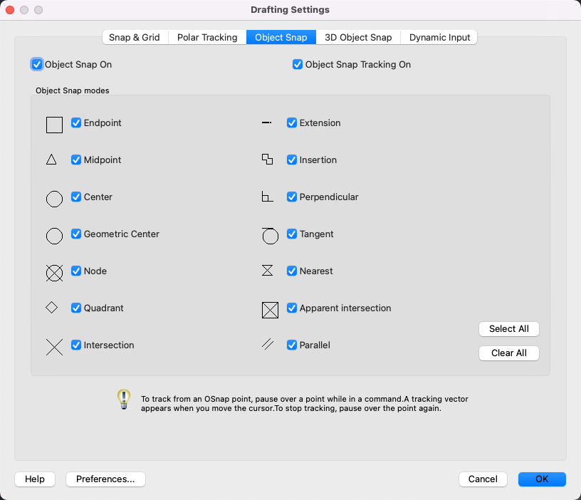

Object Snap Tab (Drafting Settings Dialog Box)
Controls running object snap settings.

Object Snap On
With running object snaps, the object snaps selected under Object Snap Modes are active while specifying points on objects when a command is in progress. (OSMODE system variable)
Object Snap Tracking On
With object snap tracking, the cursor can track along alignment paths based on current object snap modes when specifying points in a command. (AUTOSNAP system variable)
Object Snap Modes
Lists object snaps that you can turn on as running object snaps.

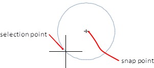

Center
Snaps to the center of an arc, circle, ellipse, or elliptical arc.

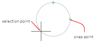

Quadrant
Snaps to a quadrant point of an arc, circle, ellipse, or elliptical arc.

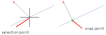

Intersection
Snaps to the intersection of geometric objects.
Extended intersections as shown below are available only as overrides during a command, not as a running object snap.
Intersections and extended intersections do not work with edges or corners of 3D solids.

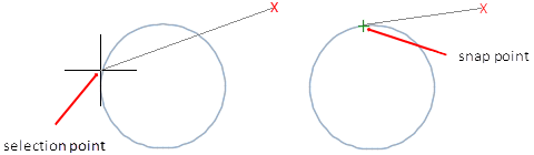

Extension
Causes a temporary extension line or arc to be displayed when you pass the cursor over the endpoint of objects, so you can specify points on the extension.
Note: When working in perspective view, you cannot track along the extension line of an arc or elliptical arc.

Select All
Turns on all running object snap modes.
Clear All
Turns off all running object snap modes.
