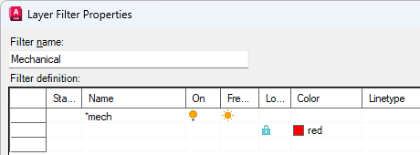

Displays the properties of layers that determine which layers are listed. You can click to specify one or more properties to define the filter. All the properties specified on a single line in the filter definition must be true to display a layer name (a logical AND). Subsequent lines in the filter definition each specify alternative criteria (a logical OR).
Here is an example:
This filter has been named Mechanical, and the filter definition includes the following criteria:

Enter a layer name, or a partial layer name with standard wild-card characters. For example, enter *mech* to include all layers with the letters mech in the name.
Click a cell in the On column and then Click the On, Off, or blank icon. The blank icon specifies that the setting does not matter.
In each of the other columns, first click a cell in the column to display several icons or the [...] button, then click the setting to specify a filter.
