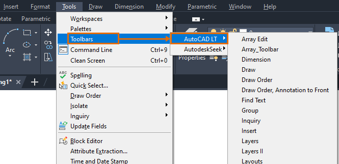

- To display the toolbars you require:
- Click
				 and select the required toolbar.
- Repeat until all required toolbars are visible.
