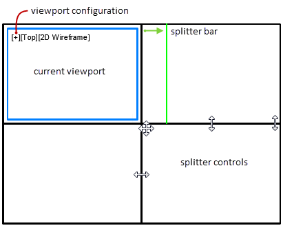

		When you display multiple viewports, the one that is highlighted with a blue rectangle is called the
		  current viewport.

Modify Model Space Viewports
		You can modify the size, shape, and number of model space viewports in a viewport configuration:
		- Choose from several viewport configurations by clicking the [+] or [-] control in the top-left corner of a viewport.
- Drag the boundaries of viewports to adjust their size.
- Press CTRL while dragging viewport boundaries to display the green splitter bar and create new viewports. Alternatively, you can drag the outermost splitter controls.
- Drag a viewport boundary onto another boundary to remove a viewport.
		After you create a new viewport, you might want to maximize and center the view by double-clicking the mouse wheel to perform a zoom extents.
