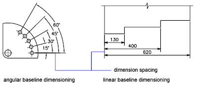

- Control the spacing between successive dimension lines in baseline dimensions
