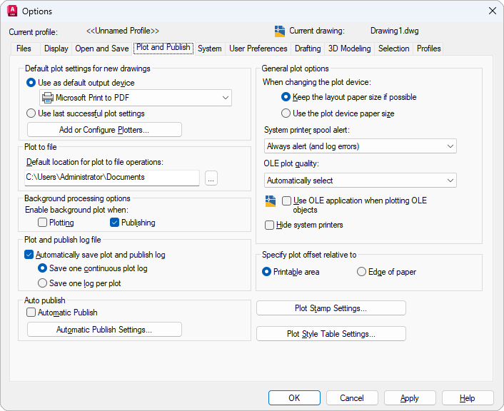

Controls options related to plotting and publishing.
OPTIONS (Command) Find
The following options are displayed.
Controls default plotting settings for new drawings or drawings created in AutoCAD Release 14 or earlier that have never been saved in AutoCAD 2000 or later format.
Sets the default output device for new drawings and for drawings created in AutoCAD Release 14 or earlier that have never been saved in AutoCAD 2000 or later format.
The list displays any plotter configuration files (PC3) found in the plotter configuration search path and any system printers that are configured in the system.
Sets the plotting settings to match those of the last successful plot.
Displays the Plotter Manager (a Windows system window). You can add or configure a plotter with the Plotter Manager.
Specifies the default location for plot to file operations.
You can use background plotting to start a job you are plotting or publishing and immediately return to work on your drawing while your job is plotted or published as you work.
Background plot and publish details are available through the Plot and Publish status bar icon shortcut menu.
You can plot or publish jobs in the background even if the program is not running by entering acad/pl <DSD file name> at the Windows Command Prompt. (Not available in AutoCAD LT)
Controls whether background plotting is turned on or off for plotting and publishing. (BACKGROUNDPLOT system variable)
Plotting: Specifies that plot jobs are processed in the background.
Publishing: Specifies that publish jobs are processed in the background.
Controls options for saving a plot and publish log file as a comma-separated value (CSV) file that can be viewed in a spreadsheet program. To view or change the location of the log file, see the Files tab in the Options dialog box.
This log file contains information about plot and publish jobs such as:
Specifies that a log file that contains information about all plot and publish jobs is automatically saved.
Specifies that a single log file that contains information about all plot and publish jobs is automatically saved.
Specifies that a separate log file is created for each plot and publish job.
Specifies whether drawings are published automatically to DWF, DWFx, or PDF files. You can also control options for automatic publishing.
When this options is selected, drawings are published to DWF, DWFx, or PDF files automatically when you save or close a drawing file. (AUTOMATICPUB and AUTODWFPUBLISH system variables)
Displays the Auto Publish Settings palette where you can customize the settings for publishing including when it occurs and the location to store the published files.
Uses the paper size specified in the Page Setup dialog box as long as the selected output device can plot to this paper size. (PAPERUPDATE system variable = 0)
If the selected output device cannot plot to this paper size, the program displays a warning message and uses the paper size specified either in the plotter configuration file (PC3) or in the default system settings if the output device is a system printer.
Uses the paper size specified either in the plotter configuration file (PC3) or in the default system settings if the output device is a system printer. (PAPERUPDATE system variable = 1)
Controls whether you are alerted when the plotted drawing is spooled through a system printer because of an input or output port conflict.
Sets the default plot quality for OLE objects. (OLEQUALITY system variable)
Controls whether the source application of an embedded OLE object loads when plotting. (OLESTARTUP system variable)
Controls whether Windows system printers are displayed in the Plot and Page Setup dialog boxes. This option hides standard Windows system printers only. It does not hide Windows system printers that have been configured using the Add-a-Plotter wizard.
You can control the size of the list of devices in the Plot and Page Setup dialog boxes by moving a device's PC3 file out of the Plotters folder and its subfolders.
Controls whether the plot offset is relative to the printable area or to the edge of the paper. (PLOTOFFSET system variable)
Specifies that the plot offset is relative to the printable area.
Specifies that the plot offset is relative to the edge of the paper.
Opens the Plot Stamp dialog box.
Opens the Plot Style Table Settings dialog box.
