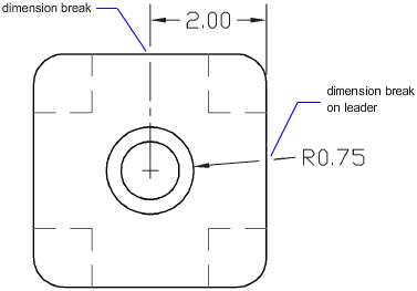

With dimension breaks, you can keep the dimension, extension, or leader lines from appearing as if they are a part of the design.
Dimension breaks can be added to a dimension or a multileader automatically or manually. The method that you choose to place dimension breaks depends on the number of objects that intersect a dimension or multileader.
