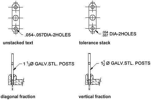

Stacked text refers to the fraction and tolerance formats applied to characters within multiline text objects and multileaders. Characters representing fractions and tolerances can be formatted to conform to several standards.
You use special characters to indicate how selected text should be stacked.
By default, numeric characters entered before and after a forward slash, pound sign, or caret stack automatically. For tolerance stacking, the plus sign (+), minus sign (-), and decimal point (.) also stack automatically.
