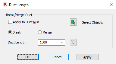

To break or merge multiple duct segments
To… | then… |
apply the length to the entire run | select Apply to Duct Run. |
manually select duct segments to modify | click ![]() |
break a segment | select Break, and enter a value for Duct Length. You can also click ![]() |
merge multiple segments | select Merge, click the Select Object icon, and select the segments to merge. Note: When merging segments, you cannot cross fittings to join segments.
