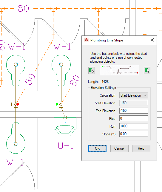

You can also use the plumbing line slope tool to compute the start elevation, end elevation, or slope of a plumbing line based on the starting or ending points in the run. The software prompts for one of three entries — starting point of the segment, ending point, or slope. For more information, see Calculating the Slope of a Plumbing Line.
