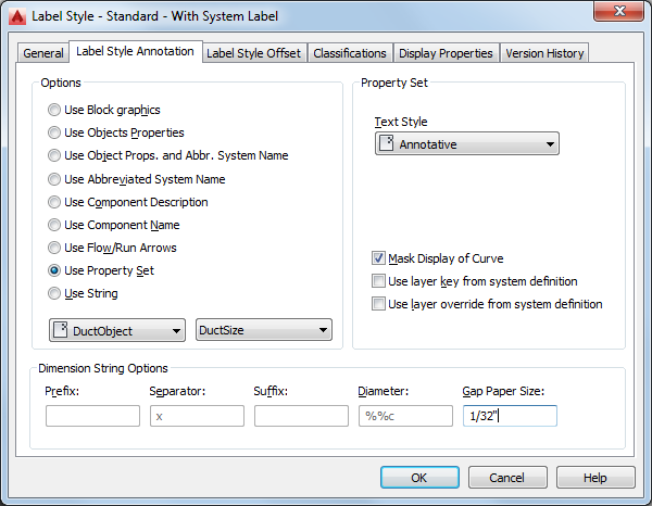

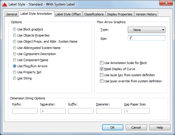

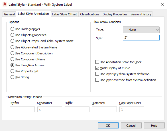

In Architecture, labels are annotative objects if the corresponding label curve style is configured to be annotative. You configure a label curve style to be annotative in one of 2 ways depending on the type of style.
If the label curve style uses block graphics or flow arrow graphics, and Use Annotation Scale for Block is selected in the style, then the style is considered annotative. (As a convenience, this is selected by default when you select a block whose Annotative property is set to Yes, but you can deselect it.)
Example block-based label curve style

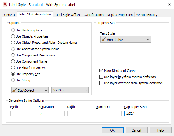

If the label curve style uses a text style, then the configuration of the text style determines whether the label curve style is considered annotative.
Example text-based label curve style
The following table describes how labels are scaled based on the configuration of the text style that is used by a label curve style.
