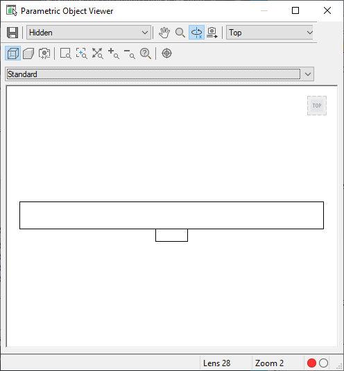

. The Parametric Object Viewer is displayed.
Parametric Object Viewer dialog box
- Select a different view from the list, or click
to view the model using 3D orbit navigation.
- In the Parametric Object Viewer, select a point on the circle, and drag the cursor along the circumference of the circle to inspect the 3D model dynamically from various viewpoints.
- With the Parametric Object Viewer open, select a different part size in the Size Parameters dialog box.
The part size is displayed in the viewer.
- Inspect the model from various viewpoints to verify that the model appears sound.
If your inspection reveals problems, such as segments that join improperly, make the necessary modifications, and inspect the part sizes again. Repeating this process until all part sizes appear sound.
