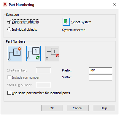

To add part numbers to an MEP system
- Click Annotate tab
Scheduling panel
Tags drop-down
Text Part Numbering Tag. Find
- Click the Rectangular, Oval, or Text Part Number tool.
- Use the Select System button to select the system objects for tagging.
- Choose whether to tag individual objects or connected objects.
- Use the Add, Update, or Remove buttons to choose your Part Numbering operation.
If you want to.... |
Use... |
create a new set of part numbers |
Add Part Number |
modify an existing set of part numbers |
Update Part Numbers |
delete an existing set of part numbers, including property sets |
Remove Part Number |
- Set the tag starting value and add any desired tag prefix or suffix information.
The tag starting value can be a number or a letter, or a combination of the two. Valid numbering sequences include:
- 1,2,3...
- A,B,C...Z,AA,AB...
- a,b,c...z,aa,ab...
- A1,A2...A9,B0,B1...
- 1A,1B...1Z,2A...
Alphanumeric Part Numbers with the Run Number (H) Followed by a Sequenced Part Number
- Click Include run number to differentiate among separate but connected runs, and enter a run designator value.
- Click Use the same part number for identical parts to set or cancel this option.
- Click OK to start tag insertion.
