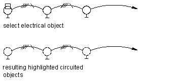

You can use the Show Circuited Devices command to highlight all devices that are part of the same circuit. This feature finds all of the devices in the current drawing that are connected to the same circuit.
Note: You can also check the connectivity of a run or individual object. For more information, see Checking Your Drawings.
To show circuited devices
- In the Electrical workspace, use one of the following methods to show circuited devices:
- Select a wire or device and click Wire tab or
- Select a device, right-click, and click Connected Objects
Show Circuited Objects.
The devices connected in the circuit are highlighted.
- Press Enter to exit the command and remove the highlighting.
Example of highlighting circuited devices
