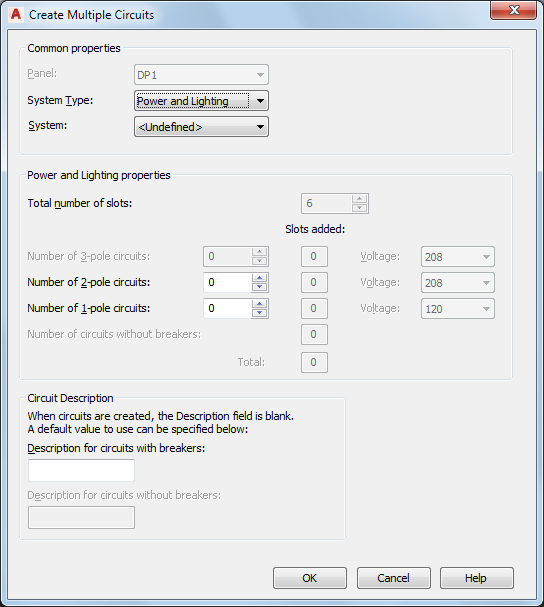

Create one or more circuits for the panel
  1. If you do not want to create circuits, skip this section and proceed to the section on inserting the panel. Otherwise, expand Circuits, and for Create circuits, select Yes.
  2. Beside Circuit Settings, click .
  3. On the Circuit Settings worksheet, for System Type, select the system type of the circuits: Power and Lighting, General, or Other.
    Note: If you select Power and Lighting or Other for the system type, the connectors on the electrical objects in your drawing must have the same system type in order to be placed on the circuit. To allow devices of any system type to be connected to the circuit, select General for the system type. The General system type allows objects of different system types to connect. For more information, see Circuits.
  4. For System, select an electrical system for the circuits.
  5. Specify additional circuit properties, which vary according to the system type of the circuit:
    If the system type is… then…
    Power and Lighting Do the following:
    • Enter the total number of slots on the panel.
    • Enter the number of 1-pole, 2-pole, and 3-pole circuits to create. You can only create 3-pole circuits if you selected 3 for Phases on the Properties palette.
    • For each type of circuit to create (1-pole, 2-pole, and 3-pole), select a voltage. You can select from the voltages defined in the drawing that are valid for the number of poles.
      Note: If the number of 1-pole, 2-pole, and 3-pole circuits is less than the number of slots, the remaining circuits will be created with a rating of 0.
    General or Other for Number of circuits, enter the number of circuits to create.
  6. For Circuit Description, specify the description for circuits with breakers and circuits without breakers that will display in the Circuit Manager when new circuits are created.

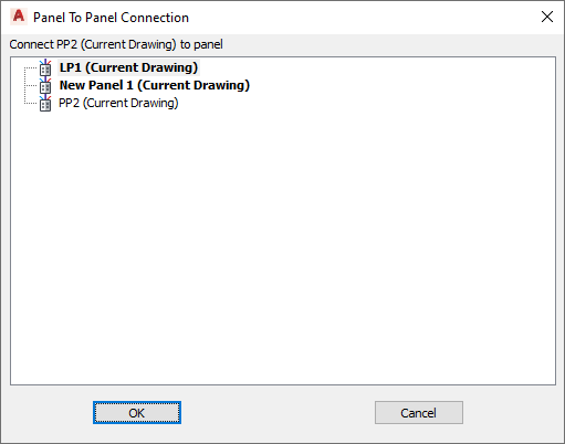

Link the panel to an existing panel
  1. If you do not want to link this panel to an existing panel, skip this section. Otherwise, select the panel, right-click, and click Connect To.
  2. Select the panel that you want to connect to and click OK.
    Note: Valid connections are shown in bold.

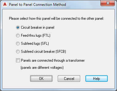

  3. Select the method to use when connecting the panels and click OK.
    If you select… then…
    Circuit breaker in panel the panel is added as a subfed panel to an existing circuit in the linked panel.
    Feed-thru lugs the panel is added as a subfed panel to a feed-thru lug in the linked panel.
    Subfeed lugs the panel will be added as a subfed panel to a subfeed lug circuit in the linked panel.
    Subfeed breaker the panel will be added as a subfeed panel to a subfeed breaker circuit in the linked panel.
    Panels are connected through a transformer (panels are different voltages) the panel will be connected through a transformer when panels are of different voltages.
