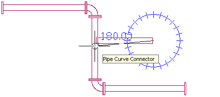

When you use AutoCAD MEP 2026 toolset snaps, the software inserts an appropriate fitting when needed, as shown in the following example of adding a pipe branch.
Snapping a pipe to an existing run using the pipe curve connector
Resulting branch with an inserted fitting
