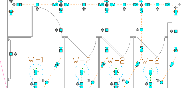

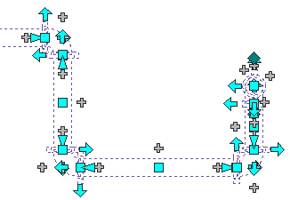

- Select multiple objects using the Select Connected Branches command.
Example: Selecting connected branches in a pipe run
Example: Selecting connected branches in a plumbing run

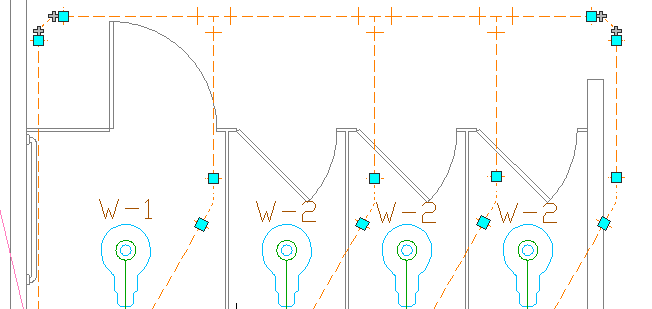

The following examples show selection sets filtered by part type, where only the elbows in each run are selected.
Pipe run
Plumbing run
