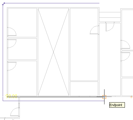

  3. In the drawing, select a point on the geometry.
    You can use object or AutoCAD MEP 2026 toolset snaps to select points on the geometry.
  4. Continue selecting points along the geometry.
