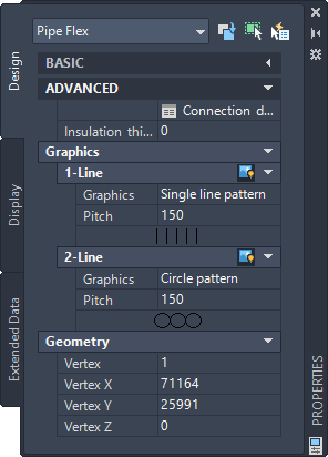

Defines the properties on the Design tab of the Properties palette to use to modify the piping system.
Advanced properties are collapsed by default. To view advanced properties, click (Down arrow).
The Design tab is divided into two sections: Basic and Advanced.
Advanced properties (includes pipe flex properties)
Property | Description |
Connection details |
Click Note: For more information, see Connection Details.
Anchors (for fittings) |
Click ![]() |
Insulation thickness |
Specifies the insulation thickness of the current pipe segment |
**Graphics |
Specifies the pattern for flexible pipe |
**Pitch |
Specifies the pitch value for flexible pipe |
**Geometry |
Used when you modify the layout of flexible pipe |
