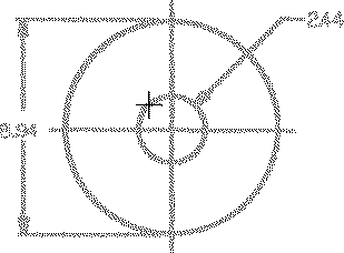

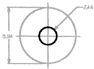

This object type is available only in bitonal images. The following example was defined using the Smart selection method for primitive objects. AutoCAD Raster Design toolset detects the circle and defines the entity as a circle primitive object.
Entity selected using Smart selection |
Primitive object defined from the selection |
After you have defined a REM object, you can use AutoCAD commands to modify it. For more information, see Using AutoCAD Commands on REM Objects.
