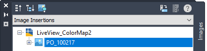

If the
Image Manager toolspace is not open, on the ribbon, click
Raster Tools tab |

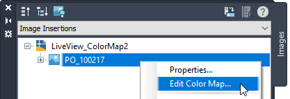

| 3 |
In the Image Insertions view, expand the LiveView_ColorMap2 node, right-click the image name and choose Edit Color Map. |

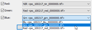

| 4 |
In the Band Assignment Color Map dialog box, note that the red, green, and blue channels on the left are assigned to the corresponding red, green, and blue data bands. |
| 5 |
In the Band Assignment Color Map dialog box, use the three drop-down lists to assign the color channels as follows:
Click Apply to see the change immediately, and click OK to close the dialog box. |
| 6 | This color map shows vegetation as red. Vegetation that is healthy or more dense appears darker red. This type of display is known as a false color image, and this particular band assignment is commonly used for analyzing vegetation. |
