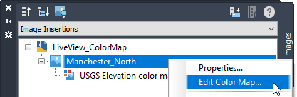

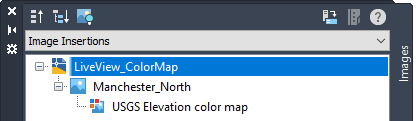

| 3 |
In the Image Insertions view, expand the LiveView_ColorMap node, right-click the image name and choose Edit Color Map. |

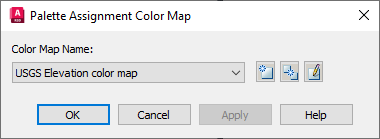

In the
Palette Assignment Color Map dialog box, click

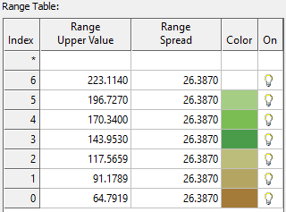

| 5 |
In the Palette Color Map Definition dialog box, in the Range Table, note that each color on the map represents an elevation range of 26.387 m. Click OK to close the dialog box. |
| 6 |
In the Palette Assignment Color Map dialog box, select Slope Color Map from the drop-down list, and then click Apply. The colors on the map now show ranges of ground slope values. |
