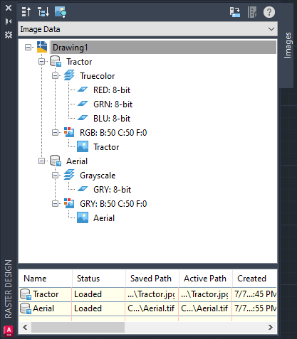

Image Manager, showing the Image Data view

The Image Data view is more data-centric, as shown in the figure. Here we see two image data definitions on the left (Airport and Contour), with their subordinate band groups (Truecolor and Bitonal) and color maps (RGB and BIN). The image insertions are shown subordinate to their color maps. In this example, each insertion uses the same name as its parent data definition. This view is ideal for creating new insertions and working with image data. If the drawing contained multiple insertions of the Tractor image, the Tractor branch of this tree view would show a separate color map and insertion object for each one. The image listed at the top of the Image Manager toolspace is at the top of the display order. The image listed last is underneath all the others. To modify this order, drag the names of the images up or down in the list.
