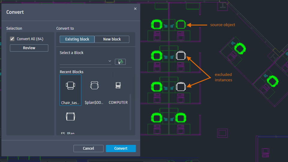

Block convert: BCONVERT command now zooms to selected objects. The Convert dialog box also includes the option to assign blocks to layers. Additionally, the new BCONVERTINCLUDEEXISTINGBLOCKS system variable determines whether existing block instances are selected by the BCONVERT command by default.
