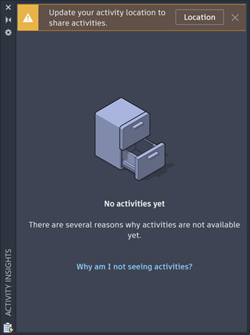

  3. If the Activity Insights palette is not open, click View tab > History panel > Activity Insights. Find
  4. Click Location on the Activity Insights palette.

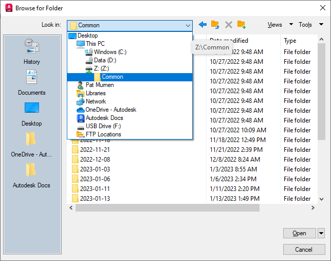

  5. Browse to and select a location that you share with your collaborators to track drawing activities.
    In this example, I have an internal network drive mapped to Z: with a Common folder under that which I select for my shared location.
  6. Click Open.

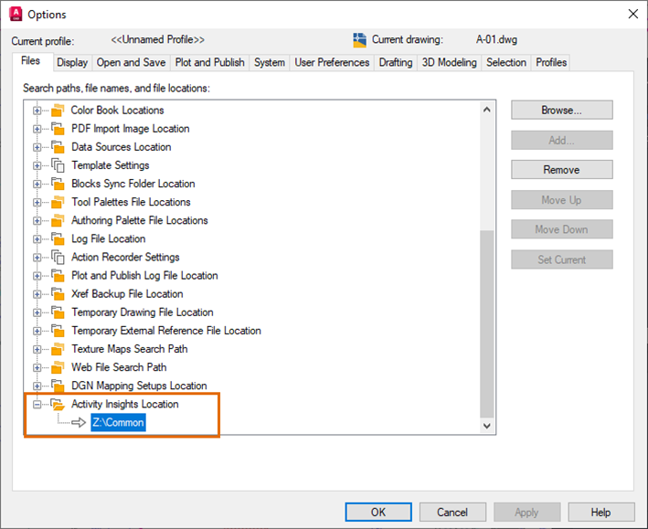

  7. Note: If Location is not available on the Activity Insights palette, do the following:
    1. Click Application button > Options.
    2. On the Files tab, click the plus sign (+) to the left of Activity Insights Location to expand the node.
    3. Select the current file path, click Browse, and select the shared location.
    4. Click OK.
    Note: Drawing activities may be lost if the activity location is changed later.
    Once all your collaborators set the same location for Activity Insights, all drawing activities are written to and read from this location.

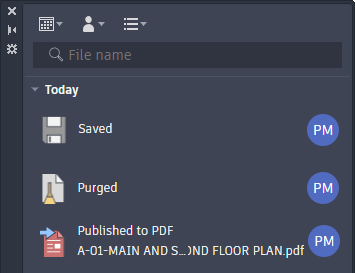

Drawing Activities
So, what activities might you see for your drawings? Let's try a few commands and see what shows up on the Activity Insights palette. You can use your own drawings for these exercises or download the sample drawings.
Note: Activities are logged even when the palette is closed. All activities are displayed the next time the palette opens.
  1. Open A-01.dwg or a drawing of your own.

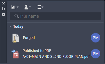

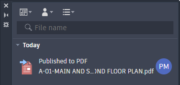

  2. Click Plot, select a plotter or PDF output device, and click OK. Find
    The Published activity displays on the palette.
    Note: The specific published activity depends on the device or output selected.
  3. Click Purge, select All Items, and click Purge All. Find
    The Purged activity displays on the palette.
  4. Draw some geometry, for example some circles and lines.
  5. Save the drawing.
    The Saved activity displays on the palette.
    Note: Some activities don't display on the palette until after you save the drawing.

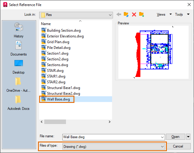

    For the xref drawing, I'll use the Wall Base.dwg from the downloaded sample drawings.
  3. Click Insert tab > Reference panel > Attach. Find
  4. Confirm the Files of Type is set to Drawing (*.dwg), browse to and select Wall Base.dwg. Click Open.

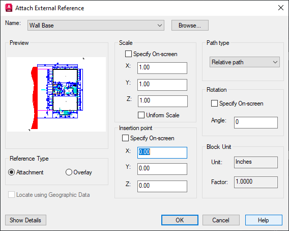

  5. Use the settings shown in the following image and click OK in the Attach External Reference dialog box.

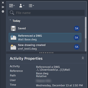

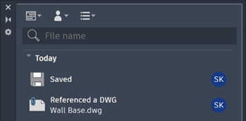

  6. Save the drawing.
    The Referenced a DWG activity is added to the palette.
  7. Click the activity to see details.

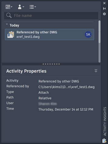

    The drawing opens and the Activity insights palette displays the activities for the drawing.

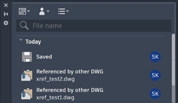

  11. Click the Referenced by other DWG activity to see its details.
    Now we are going to attach the same drawing in a second drawing to see how this becomes useful.
  12. Start a new drawing and save it as xref_test2.dwg.
  13. Attach the same drawing as an Xref as in the earlier steps.
  14. Switch over to the referenced drawing, in my case Wall Base.dwg.
    When you open a drawing, an activity is shown for each drawing that references the open drawing.
Note: Once Activity Insights is tracking activities for all collaborators, you'll have an easy way to see which drawings reference a particular drawing before you make any changes to it.

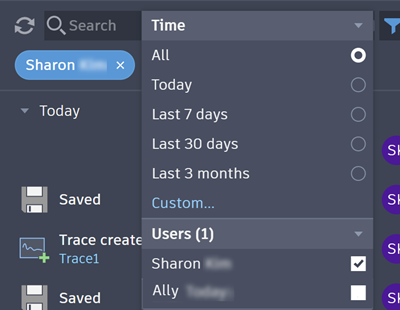

By Time
  1. Click the filter icon.
    Under the Time filter menu, you can select from the available options or select Custom to define a range of dates.
  2. To select a date range, select Custom. Then, turn the Date Range toggle at the bottom right on. Then, select the earliest date and then the latest date. Your chosen range will now appear in the Time menu.
  3. To display activities regardless of date, select All from the Time category.
