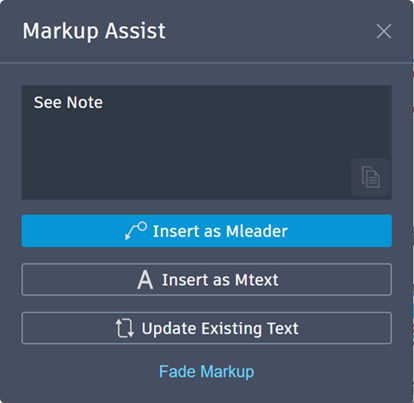

Update Existing Text
After clicking a text markup, you'll see Update Existing Text as a new option in the Markup Assist dialog box alongside Insert as Mtext and Insert as Mleader, which were available in the last release. Use Update Existing Text to replace or amend existing text in the drawing with text from an imported markup.
To update existing text:
  1. Click the highlighted border of a text markup. The Markup Assist dialog box opens.
  2. Select Update Existing Text.
  3. Select existing text in the drawing that you want to replace.
  4. Choose one of the following:
    • Append. Adds the text that was selected from the markup to the end of the text field and keeps the existing text.
    • Replace. Adds the text that was selected from the markup and removes the existing text.
    • Select a strikethrough. Select a strikethrough markup (text that has been crossed out with a markup), and the text that was selected from the markup will replace the drawing text and fade the strikethrough markup.

Markups With Associated PDF Text Comments
Text comments that are added to a PDF using Adobe software will display and can be inserted into the drawing as an Mleader or Mtext, or used to update existing text.
To insert text from a PDF text comment:
  1. Click the markup that contains a PDF text comment.
  2. The Markup Assist dialog box opens.
  3. Insert the text as an Mleader, Mtext, or Update Existing Text.

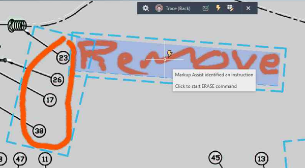

Instruction Text on a Markup
Markup Assist detects certain instructions in markup text that are linked to commands such as "MOVE," "COPY," or "DELETE." When Markup Assist identifies an instruction, you can click that instruction to start the associated command.
