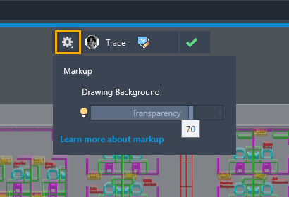

When viewing imported markups, you can change the background transparency to adjust the visibility of the imported markup.

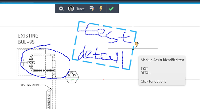

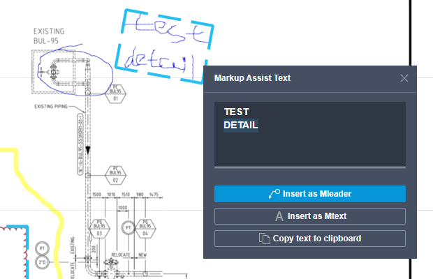

Markup Assist automatically identifies markups as text, leaders, and revision clouds. Click an identified markup, then insert it as an mtext, mleader, or revcloud object. You can edit the text before inserting it, or choose to copy the text to the clipboard.
The markup file can be a digital copy, a photograph, or a scanned version of the original drawing.
Inserting the object adds it to the drawing as geometry.

MARKUPPAPERTRANSPARENCY - Controls the level of transparency when a digital markup is active.
