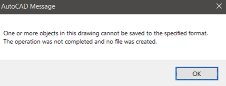

There are times that the you may receive the following message, which will prevent you from saving the current drawing:
