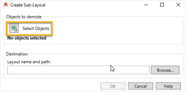

Select the Factory tab > Layout panel > Create Sub-Layout
Click the Select Objects button to start selecting objects in the canvas.

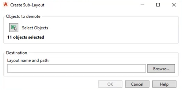

Select objects in the canvas.
Hit enter to go back to the Create Sub-layout dialog box.
Include a location to store the sub-layout file or click the Browse icon to browse for the location.
Enter a name for the new sub-layout in the File Name field.
Click OK to save your changes.
When done, all the selected objects are placed into a sub-layout and is automatically referenced to the layout you’re working on.
