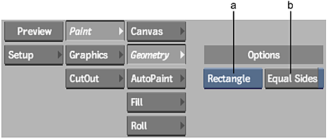

Use the Rectangle option to draw rectangles or squares.
To paint a rectangle or square:
  1. Click Geometry to display the Geometry menu.
  2. Select Rectangle from the Geometry box.
    The Equal Sides button appears.
    (a) Geometry box (b) Equal Sides button
  3. To draw a square, enable Equal Sides or press and hold P.
  4. Press the cursor on the canvas to anchor the first corner of the rectangle. Drag the cursor to size the rectangle.
  5. When the rectangle is the required size, release the cursor.
    A brush stroke is painted along the sides of the rectangle.
