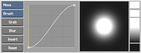

Default S-shaped curve

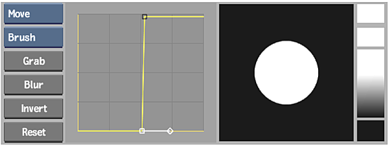

Hard edge curve

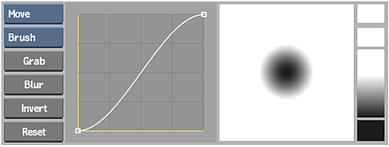

Invert brush curve

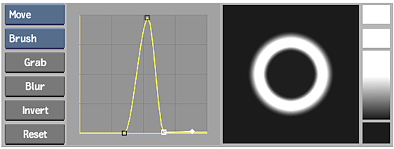

Ring-shaped brush curve
