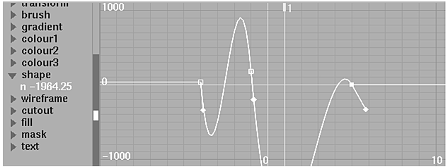

To animate the shape of an object, you must create keyframes with the Shape Animation controls. Each shape you define becomes a keyframe in the Shape channel of the Animation editor. The difference between the keyframes is interpolated and the shape animation is created.
The Shape channel is used to identify the number and location of shape keyframes in a clip. Use the shape curve to control the rate at which an object changes to a new shape. The following figure shows the Shape channel for an object that changes from shape 1 in frame 1, to shape 2 in frame 8, and shape 1 in frame 15.
