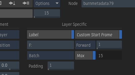

Changes to the Custom Start Frame layer.
The Custom Start Frame options in the Frame layer change how its value is computed. When you enable Custom Start Frame:
- The Max value is now calculated using the Start Frame of the Layer and the Duration of the Setup: changing the Start Frame automatically updates the Max value by the Duration.
- You can now switch between the Batch Setup duration and a custom value in Batch and Batch FX.
