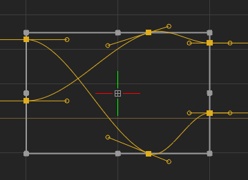

Edit Box
Flame Learning Channel: Updating the Animation Editor - The Edit Box
You can now use the Edit Box to transform a selection of multiple keyframes in the Animation editor.
To display the Edit Box:
  1. In the Curves or Dope Sheet view, Ctrl+Drag to select keyframes.
    Tip: If the Edit box does not appear, select Show Edit Box.
For more information, see Edit Keyframes with the Edit Box.

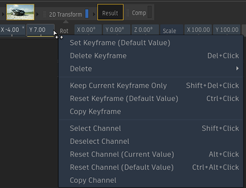

Timeline FX Numeric Field
You can now use the context menu on the numeric fields in the Timeline FX Ribbon to perform the following operations:
