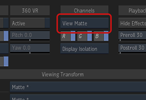

Display the OutMatte in the Player
To display the OutMatte of the current frame in the Player:
  1. Do one of the following:
    • In the Player's Viewing Settings panel (Alt+1), select Channels Show RGB Show Matte.
    • Use the Toggle RGB/Matte Channels keyboard shortcut: Shift+M
Note: The Matte is the output of the clip positioner, not the timeline segment. In some situations, especially in vertical composites, the displayed matte might not be the matte you expected.
