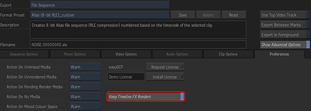

Keep Timeline FX Renders
When exporting content with Timeline FX as a Background task, the export renders every non-rendered Timeline FX. Once the export completes, the renders are usually flushed.
You can now keep these rendered frames by selecting, in the Media Export window, Show Advanced Options Preferences Keep Timeline FX Renders.
