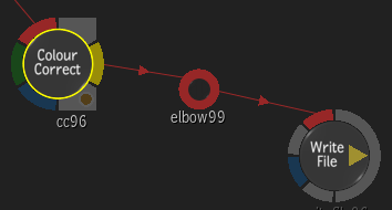

Improved Elbows
Elbow object in the schematic have been improved:
