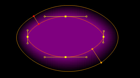

FreeThe same workflow as before: you can add and delete as many Softness control points as you need.

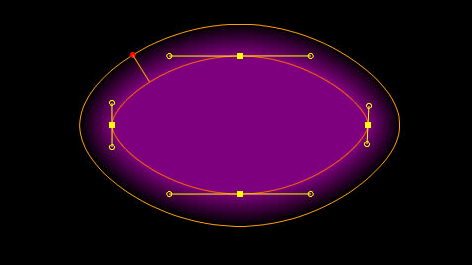

GlobalThis new mode offers a single softness point automatically added between the first and second vertices of the GMask. That point cannot be moved or deleted, and no new point can be added to the GMask spline.

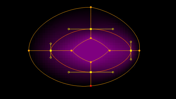

VerticesThis new mode offers control points at each GMask vertex, with a point for each of the inner and the outer softness.

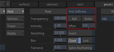

Adding and deleting a Softness control point in Free mode is now simpler.
Adding a Softness point:
  1. Select the GMask.
  2. In Free Softness, click Add to insert a control point.
    Tip: First select vertices to insert a control point between each pair of vertices.
You can also use the GMask: Add Softness Point(s) keyboard shortcut.
Deleting a Softness point:
  2. Select one or more points.
  3. In Free Softness, click Delete.
Tip: You can also use the GMask: Delete Selected Softness Point(s) keyboard shortcut.

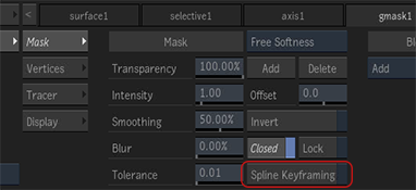

The GMask Auto Key button is now located in the Mask submenu, and renamed Spline Keyframing.
Enable Spline Keyframing to create key frames for the GMask spline even when Auto Key is disabled.
