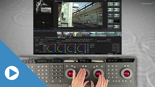

Tangent Panel Tutorials
Grading with the Tangent ARC Panels—Credit: Tony Richards
Grading with the Tangent Element Panels—Credit: Tony Richards
