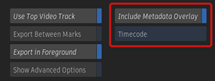

To burn the Metadata Overlay on export:
  1. In the Media Export window, select Include Metadata Overlay .
  2. From the Metadata Overlay Selection box, select the overlay to burn on the exported media.
Note: If you save an export preset, the status of Metadata Overlay is included in the export preset.
