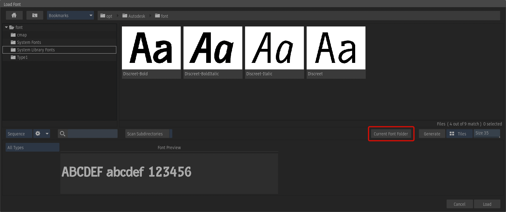

Configuration Folders
The home location for the Load Font file browser can be defined in the configuration_folders section of the sysconfig.cfg file.
In this section, only the listed font path can be modified; no new items can be added.
When a setup is loaded, the application looks for the font in the file path saved in the setup. If it cannot find it, it then looks for a font of the same name in:
When opened, the Load Font file browser sets the file path to the current font location. If the current font is the factory default (Discreet), the path from the sysconfig.cfg file is used instead.
If the current file path does not correspond to the location of the current font, you can navigate to it using the Current Font Folder button.
