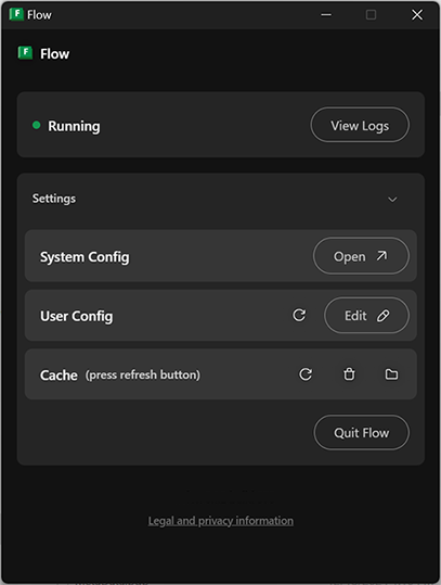

The Flow desktop service connects your local Maya Animate in context capability to Flow Production Tracking. On Windows and Linux, it's installed automatically with Maya 2026, and is available from the task tray by clicking the Flow desktop service icon Flow desktop service.
With this application you can do the following:
View Logs
The Flow desktop service manages two local servers:
Each server maintains a log with status information, including the running URL and port, and any errors the server may have encountered. Click View Logs to view detailed information on these local servers.
Edit the Configuration File
There are two configuration files that Flow uses:
If you edit either config, you must click the reload button to restart both servers and for the changes to take effect.
Manage the Local Data cache
The Flow desktop service stores data locally in the location specified by the BLOB_STORAGE_ROOT_DIRECTORY setting in the System Config (or User Config if overridden there). The Cache section of the Flow desktop service UI will display the size of the local data. You can perform the following operations:
Close or Quit Flow desktop service
To close the Flow desktop service window, click the close button in the upper right-hand corner of the UI. This will keep the service active in the task tray.
To quit the service and shut down both servers, click Quit Flow desktop service in the Settings. This will disable the Animate in context capability.
If you want to start the service anew, click the Flow desktop service application icon. You can find this in your OS's respective app list. Be careful not to run multiple instances of the Flow desktop service this way, as that can cause unexpected behavior.
