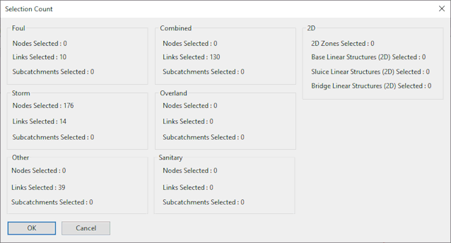

Selection Count Dialog
For InfoWorks networks, this dialog shows the number of nodes, links and subcatchments included in the current selection for each system type. If the network includes 2D objects, the number of 2D zones and base, bridge and sluice linear structures included in the current selection, will also be displayed.
The dialog is displayed when when the following options SelectionSelection OperationsCount Selected Objects are chosen from the GeoPlan context menu.
